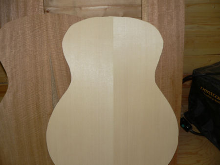

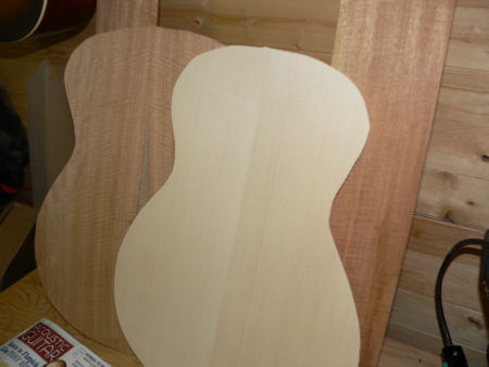

So I glued up a beautiful German spruce top (first time using German) and cut it out. Once I got it all cleaned up I noticed that the light reflects of the two halves very differntly. When you look at it straight on it looks fine but as soon as you look at it on an angle you notice the difference. The treble side looks duller while the bass side reflects a lighter colour. If I flip it over to the back it is the other way around, the bass side looks dull and the treble looks bright. So my question is what is causing this? I haven't run into this before. The only thing I can think of is that one of the sides got flipped over. The grain on this top is so nice and straight all the way through that I suppose this could have happened. My thinking is this would explain why the light reflection is opposite when I flip the top over.
Any thoughts would be appreciated. I tried taking some pictures but it did not show up that well.
Josh House

It's grain runout. Tell tale sign. There's not really any way around it, that's just the way this particular tree grew.
PostPosted: Wed May 02, 2007 9:04 am
I think it is due to the grain direction in a book matched pair of sides.  One half runs north the other south.  I only think this because I asked the same question a couple of weeks ago, but mine had to do with thicknessing with a plane and getting tearout on one side and not the other.  However, it stands to reason that one side would reflect light differently from the other.

just a fairly uninformed guess here, but if there is much run out in the top and that grain is running in the opposite direction in each half, light will reflect differently off of each side. in other words, some grain pointing slightly up and some pointing slightly down. im not sure if that is worded correctly, but some people who know what they are talking about will be along shortly...

Grain runout, as said before. As a purist thing, it's come to be frowned upon, but I wouldn't worry about it - decades of high end Martins can't be all wrong. I've never thought it was a bad looking effect.

Josh - a nice looking top - I like the pattern myself.  What is the back and sides behind it in the picture?

Thanks guys, I went out to the shop and had another look and yes it is just runout. I thought that it might have been something else. But after spinning the top around and looking at it every which way I realized that there is nothing wrong with it. It really is a nice top and it has a great tap tone.
The b&S are curly Honduran Mahogany. Both the top and back are from our friend Bobc. I just love the look of this mahogany!

Paul, I agree it's grain runout, but entirely avoidable. You can take a perfect tree and get wood like this.
Imagine a perfect quartered log, split off the face and you have perfectly quartered tops. It's when the tops are sawed out and the sawyer loses the split face, that runout begins to reflect as shown.
Not hard to understand at all, in one view you are looking into the cut off fibers, in the opposite book-matched half, you are looking past the cut off fibers. One reflects dark, one light.
Then there is the imperfect tree, where it undulates the grain. My wife's Taylor has one of these abberations. Back then I didn't yet have a handle on what this phenomenon was. Great guitar anyway. And this top will most likely make a great guitar too. Can you say sunburst?
